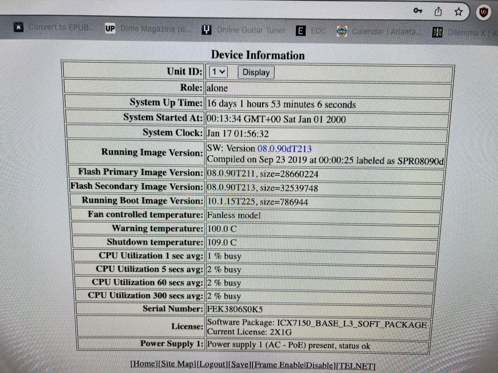

After reading many forums, I the routing preference on my Switch (ICX 7150) is messed up.
The running Image version is Complied on Sep 23 2019 at 00:00:25 labeled as SPR08090d. I think this is why when I am using the Extender, my internet lags and sometimes do not work.

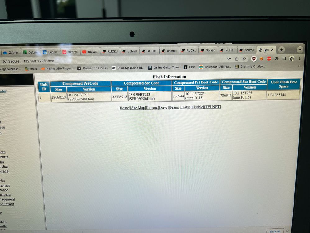

Could you please share the screenshot showing the below information to assist you further?
Please share the ALL above queries and let me know if you have any queries in this regard.
07-24-2023 09:23 AM
07-24-2023 10:11 AM
Hi @mrq201
Thank you for the response and information.
Please follow the process once again to bring your partition to the primary which is on SPS Code. (Also, sharing it below once again)
Step-by-step screenshots below:
07-24-2023 10:32 AM
Thats what I did yesterday but it didn't work. I will try it again.
