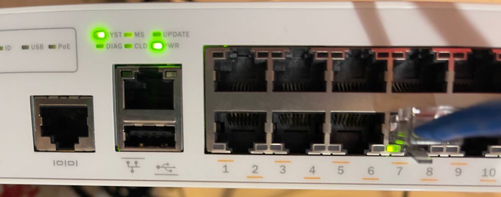

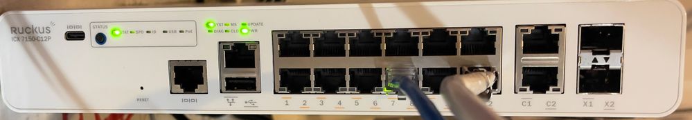

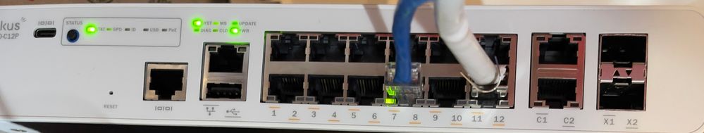

1/1/2 On Off 0 0 n/a n/a 3 voltage applied from ext src <-- Nothing connected (see photos)

I disconnected all the ports to remove any possible external power sources, and reran the commands you requested.
I am seeing port 1/1/2 is showing "1/1/2 On Off 0 0 n/a n/a 3 voltage applied from ext src "
also port 1/1/12 is a PoE device but it is not receiving power.
It seems there is an internal problem with the switch.
