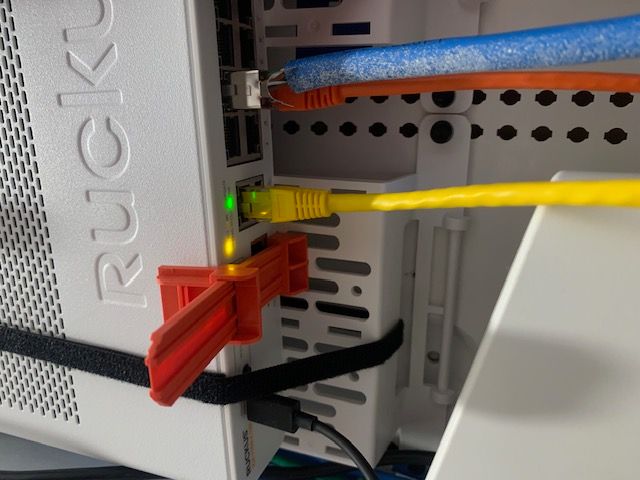

Based on the information provided, it appears that you are encountering issues with the RUCKUS ICX-7150-C12P Switch stuck in boot mode.
Could you please let me know if your RUCKUS ICX-7150-C12P Switch has an Amber/Yellow LED as shown in the picture below? If yes, the Switch is stuck in the boot mode.

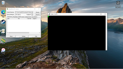

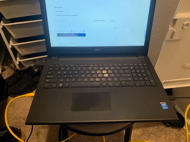

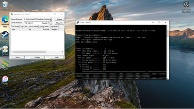

As you mentioned that you tried Software Recovery already, please let me know at what point you are stuck on, along with the Pictures of the Software Recovery cable connections between the Laptop and the Switch and screenshots (if any).

Thank you for your response on PRIVATE CHAT and sharing the requested information.
Based on the troubleshooting done, your ICX-7150-C12P Switch is not getting console access for the software Recovery process. Tried multiple steps however, the failure persists. This Switch unit Should be RMA (Return Merchandise Authorization) in simple words replacing it.
