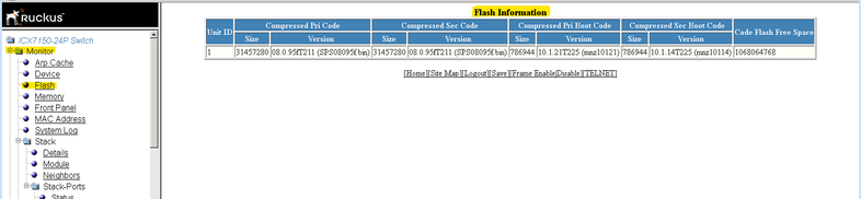

Could you please share a screenshot from Web login access of your Switch? by using the path Monitor>>Flash>>Flash Information. (Please refer to the below screenshot)

Hello. I have uploaded a screenshot. Let me know if there is anything additional you need me to upload.
02-16-2023 01:14 PM
Hi VDK
Thank you for the response and requested information you shared,
As both the partitions are running on the Switching Code. By this, we confirmed that there is no issue with the code.

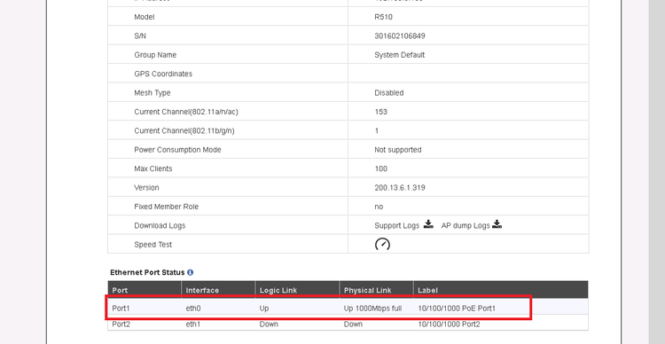

Now, we have to confirm the Speed transmitted from the Switch Ports. Please follow as described below:
To check the speed transmitted from the Switch to the Access Point: There are Two ways:
I) By IP Address of the Switch
II) By Console Access to the Switch
ICX7150-C12 Router>
show version
show inline power
show interface brief
OR

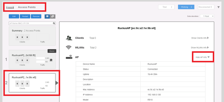

Please share the Screenshots from the Unleashed dashboard as shown in the below picture:
Once you are logged in to the ICX-7150-C12P please follow up the same steps that are on point '2'

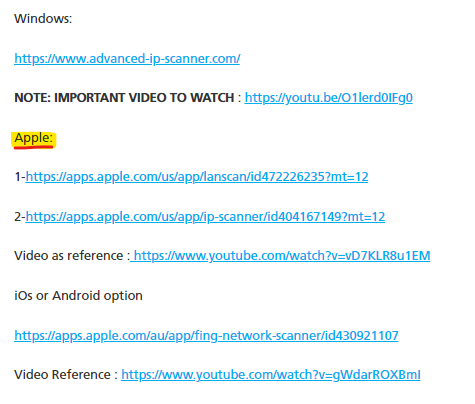

As discussed earlier, we have described in the guide how to get CLI access on Apple devices as well. Please refer to the below guide.
You must get the IP Address of the Access Point to get Access to the Dashboard. You can get the IP Address of the Access Point by IP Scanner as described in the above guide.
If you are unable to get the CLI Access or Unleashed Dashboard Access. Please get the console access to the Switch as described in ‘Point 3’ of the previous post. Getting console Access on Apple MAC is also described.
