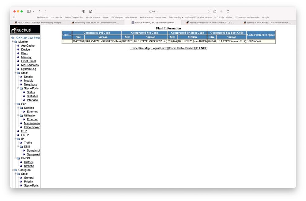

Could you please share a screenshot from Web login access of your Switch? by using the path Monitor>>Flash>>Flash Information. (Please refer to the below screenshot)

Hello. I have uploaded a screenshot. Let me know if there is anything additional you need me to upload.

As both the partitions are running on the Switching Code. By this, we confirmed that there is no issue with the code.
