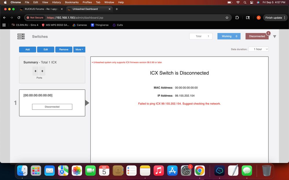

I upgraded my switch to the recommended firmware and it’s still showing disconnected
Kld88
I just need help at this point, I’ve followed all the solutions but don’t see any that have my specific issue.
My switch shows sps but I cannot type the up address in to access it considering it’s showing two switches and two different ip’s

Kld88
IMG_1133.jpgImage 9-5-25 at 4.57 PM.jpg I can log into the switch now but tried adding it and still no luck

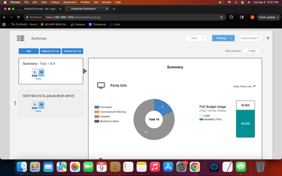

I followed your instructions and my switch is now connected, thank you very much!
