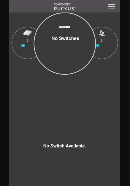

MohitJain
I don't see any switch on the dashboard.

Hi @MohitJain
Thank you for the response and update.
As you are unable to see your ICX-7150-C12P Switch in the Unleashed App. Please add the switch on the Unleashed as described below:
Make sure the management approval is enabled.
https://docs.commscope.com/bundle/unleashed-200.9-onlinehelp/page/GUID-A887C55E-6973-4496-9413-302E8...
Access Points (unleashed):
1. Hit Add on that dashboard
2. Put the IP address of the ICX switch (ICX-7150-C12P) and Password– If you don’t know the IP Address of the Switch. Please perform the below command from the Switch CLI to get the same.
Device>enable
Device#show ip address
3. Username and password for Switch authentication are the same as what you use to log in for Switch on Web or CLI (Putty).
https://docs.commscope.com/bundle/unleashed-200.9-onlinehelp/page/GUID-30C6694A-6AEE-4DF8-9459-1AB18...
To sync the data, it will take us a while, so after a couple of minutes, it should say connected.
Once the Switch gets synchronized, please check the dashboard again.
Thank you again.
