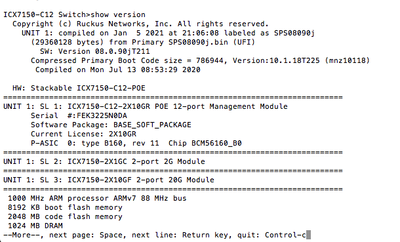

i don't know what im typing there? what is the command im tryping then what am i showing you?
Hi @horaceahenry
Please log in into the switch back when you were 'ICX7150-C12 Switch>'
Write the following command
'Show version'
Note : hit enter to accept the command
Like this example:
ICX7150-C12 Switch>show version
Like the following picture :
Copy what you get from the ouput or command  and past here over the chat
this came up. i did a hard reset on the box again and then tried to get in again and it worked, so at the "show command" i inputed show version and the picture above is what came up.
Hi @horaceahenry
Based on the troubleshooting done, and you confirm that your access points are not powering up , and the switch is on 8090j  UFI version and is not providing  power to the devices over Ethernet  , this unit Should be RMA (return merchandise authorization) in simple words replace it.
