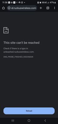

Having a different issue now.
I have two AP's. I unplugged one from power and factory reset the other. It is now broadcasting as "Configure.Me"
I connected to it and launched my Unleashed app. I pressed "Typical Install" and I get this error message: "Unable to fetch default configuration from the AP".
I tried launching a browser window to the URL: "unleashed.ruckuswireless.com" and it goes nowhere. It fails. I tried again on my phone not connected to the AP but through my 5G phone carrier signal and it still goes no where.
So I'm not really sure what to do here at this point. Last time this happened, I was able to setup my SSID and network in the Unleashed app and get back up and running, but it will not work this time.

Hi @Joey_C
Please try on a Laptop using a web browser. Please refer to the below Video for the same.
NOTE: As you have 2 R510 Access Points in your setup, remove the cables of any ONE Access Point from the Switch port, and perform the factory reset only on the ONE connected access point. Once you complete it, connect the unplugged Access point cables back to the Switch ports and it will sync up with the configurations from the factory reset Access Point.

Just wanted to drop an update.
You helped me get to the solution by suggesting using a laptop. By doing so, you are basically suggesting the problem was not my R510, but my mobile Unleashed app. So I did the equivalent of a "factory reset" on my app (which is to go into app settings -> storage -> and delete the app cache and app data). This essentially restores the app back to new as if it was freshly installed on my phone and never before used. When I did that, I was able to fetch the default configuration from the R510 and setup my network.
