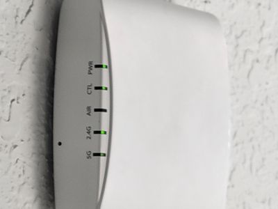

Actually I don't think I got close enough to the downstairs ap and it DOES appear to be lit up, see attached. Thanks so much and apologies for so many comments
 (see attached)

  • Also how come the upstairs ap has 24g lit up orange? That an issue?
  • It just means that the 2.4 GHz signal is up and there are no devices connected to this Radio signal. If it turns green means a device is using the same signal. The same goes for a 5 GHz signal as well. Not an issue.
Please refer to the below link for the same:
https://docs.ruckuswireless.com/unleashed/200.3/R510.html
