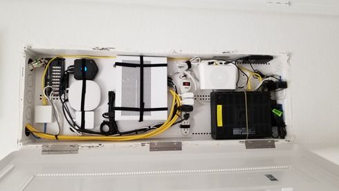

corey_salm
Image_ images_messages_5f91c440135b77e2479e9c56_469ea5769f1698538f73a991d1f0fe82_RackMultipart20181017107580sq5-daabf916-96b2-4575-80df-a6dde9713c42-1037666799.jpg1539737612
