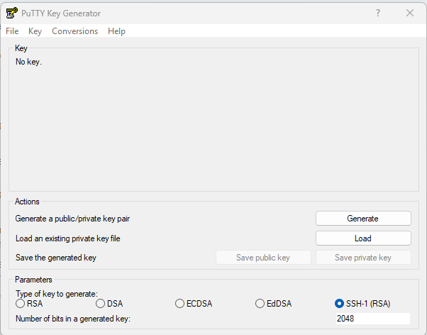

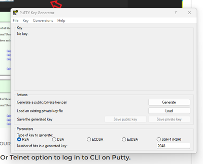

02-29-2024 07:08 AM
I installed Putty but it opens to a different window. See the attached. It is not the same as the screenshot provided. If these are the same, I am missing the step that explains how to go from the attached window screenshot to the one you share in your instructions.
