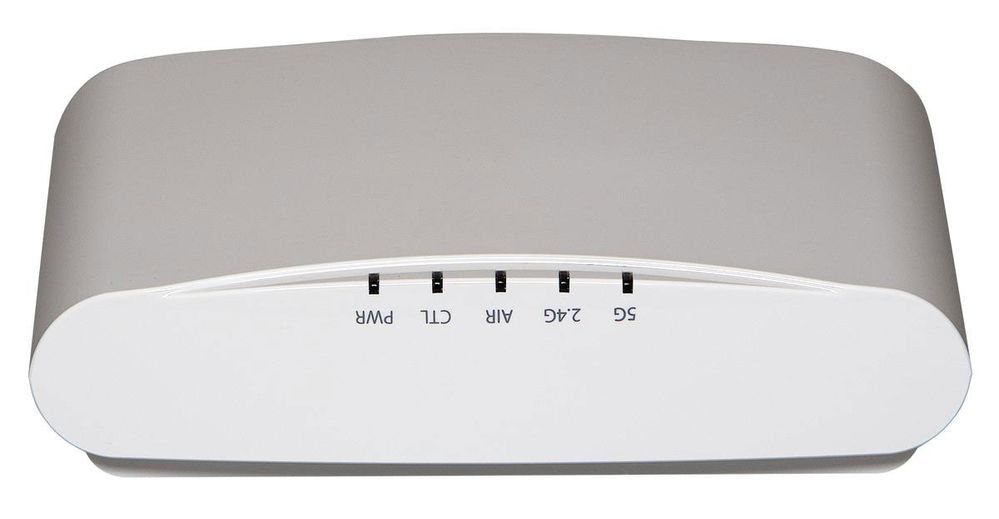

Hello,
We recently purchased the home and do not have access to the Ruckus system. Passwords given by previous owners do not work. When I try a factory reset the lights flash several times the system reboots but the previous owners names still pop up as the SSDI. The steps that I as well as an AT&T tech have take are to up plug the switch, wait sever minutes (in one case I waited several days) and plug in the switch while simultaneously holding the reset button for about 30 seconds. And same result. Is there anything else that I can try? Perhaps connect via hardwire? Thanks!
11-09-2022 12:26 PM - edited 11-09-2022 12:39 PM
Hi @BrennanS
Hope you are doing well !
Basically you do not need to reset the ICX-7150-C12P because that device only provides power to the Wireless Access Points.
Here is how to connect correctly the devices
The access point is the devices that provides wireless connectivity :
ICX-7150-C12p provides power to the wireless access points and wired connectivity
If you want to reset the Wireless Name from and pre-configured SSID ( Wireless signal ) properly you need to preform a factory reset to the Access Point .
Best Regards
Fernando Vasquez

11-09-2022 01:07 PM
Thanks so much. So I only need to reset one of my two APs if I understand you correct and I'll be able to configure through the app?
11-09-2022 01:09 PM - edited 11-09-2022 01:15 PM
Hi @BrennanS
You are totally correct ! Once you finished configuring the AP you can connect back the other Access Point to the switch
