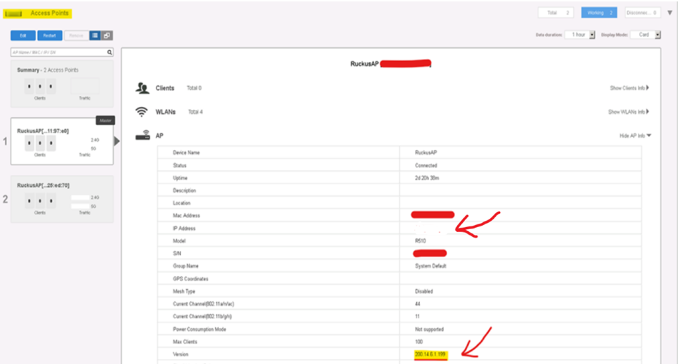

07-31-2025 06:20 AM
Ok, here is the screenshot for one of the AP's. They all are under the same version: 200.10.10.5.229.
Let me know what would be the next steps.
Thank you.
07-31-2025 06:25 AM
Hi @jmleon12
I see your Unleashed system is on an older version. I suggest you upgrade the same.
Please follow the process below.
1. Log in to the Unleashed system and upgrade your RUCKUS Unleashed system to the recommended version as described in the mentioned RUCKUS Lennar Knowledge Base self-help article.
2. After upgrading all Access Points, uninstall the current Unleashed application on your mobile device and install the updated version.
3. Attempt to log in again and verify functionality.
Should you have any questions or require further assistance, please do not hesitate to contact us.
