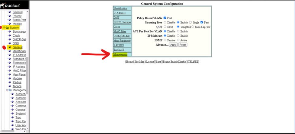

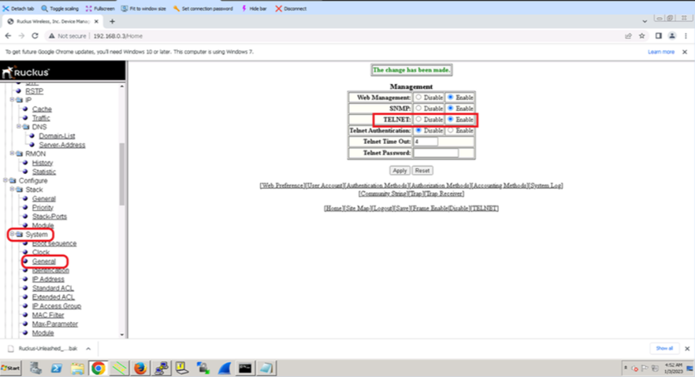

As you are able to access GUI of the Switch, I would request you to please enable Telnet through the browser by following the below screenshots:
Once you have enabled Telnet through the web browser, I request you to please login to the CLI of the Switch using the Telnet option.

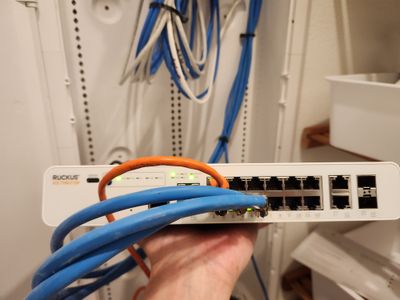

On your switch while it's plugged into the outlet, do you see any lights on? (Amber or green) Please let us know which lights are on. (Please refer to the below picture and share a picture of the same, showing the light status and the FULL Switch panel cable connections to the Switch ports)
Hi Pinky,
Thanks for the quick response. Please see the attached photos.
