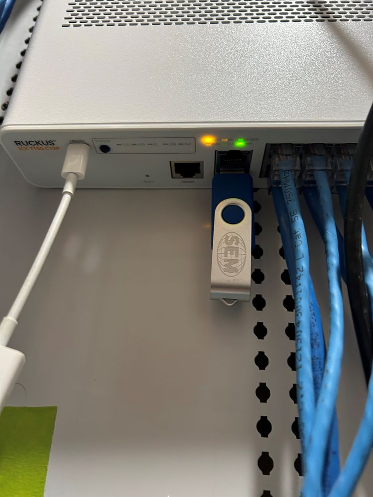

there are no lights in the access points. the power in the switch has green light.
07-12-2023 07:54 AM
07-12-2023 08:06 AM
Hi @vani
Based on your description, if the switch has one green and one yellow light, it means that the switch is stuck in boot mode. To solve this issue we need to perform factory reset process.
