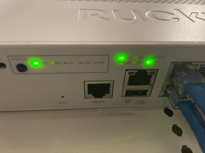

1-On your switch while it's plugged into the outlet, do you see any lights on? (Amber or green) Please let us know which lights are on?

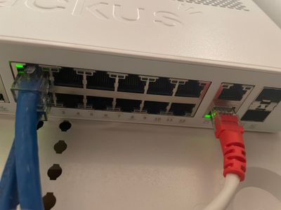

This is what I’ve got going on right now. The two blue wires are labeled upstairs and downstairs WAP, and the red/white cord leads to ISP router

Thanks for the pictures, based on the description seems the Switch is online, no we need to gain access to the Switch, so we need to find out the IP address, let me add the guide and the next troubleshooting steps.
1I will advise wiring a computer directly to the Switch(use an Ethernet cable, any of the empty ports where the access Points are connected will work), so the computer and the Switch will be in the same network.
2:Now you know the IP address of the Switch, copy and paste it into the URL bar(any web browser will work), the computer must remain connected to the Switch during all processes, if ask for credentials try the next bundle.
