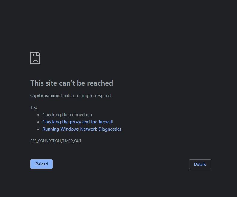

Our internet download speed(800 mbits) and upload speed (500 mbits) have been great, it is just that certain websites and services are having issues buffering/connecting/resolving and eventullay just timeout. Here is an example screenshot of website just timing out. I have to hit ctrl+f5 repeatedly for a couple minutes and it might work. This occurs in any browser, I have tested google chrome and mozilla firefox.

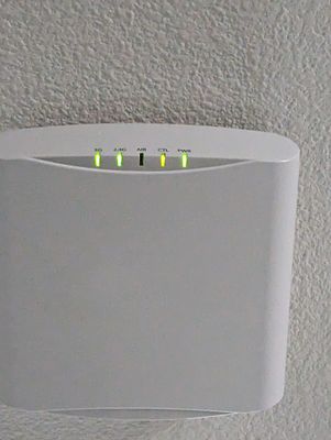

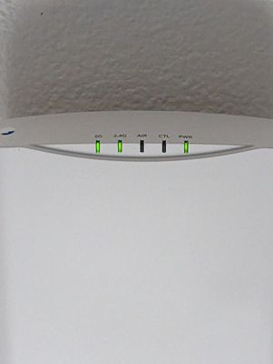

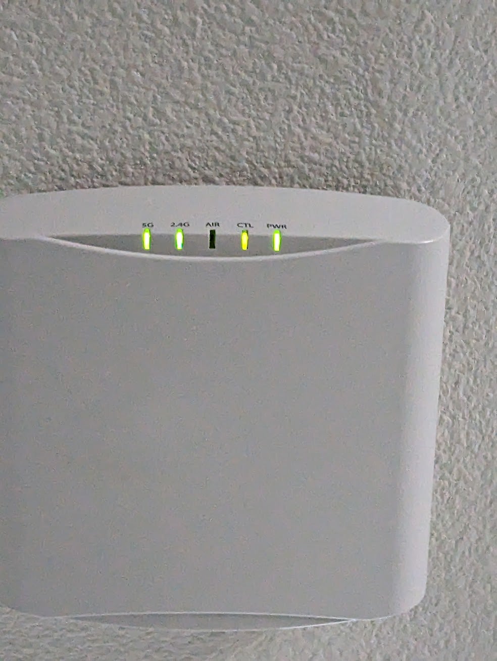

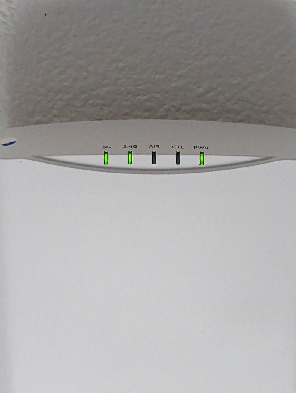

Here are screenshots of the ruckus system lights

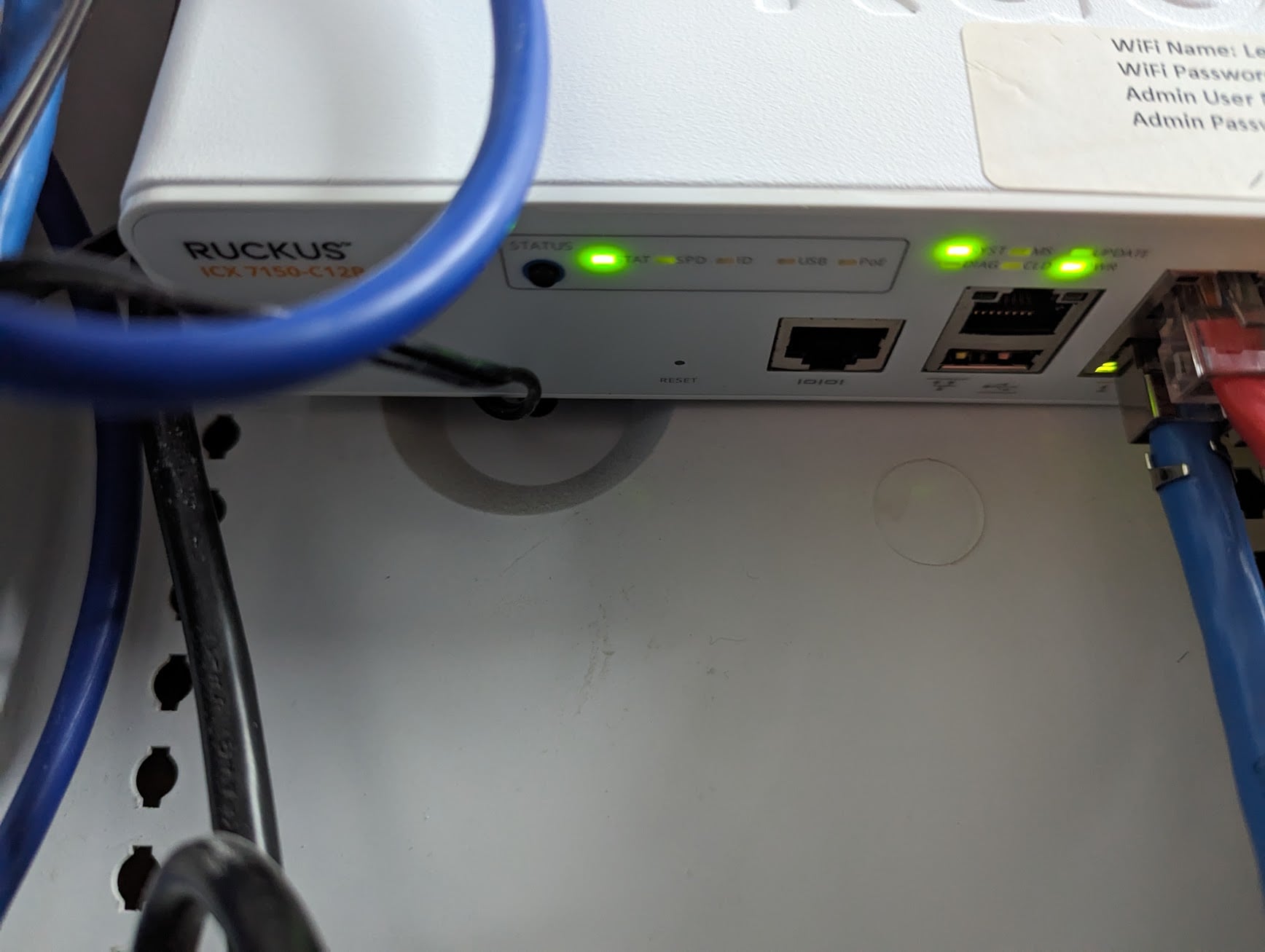

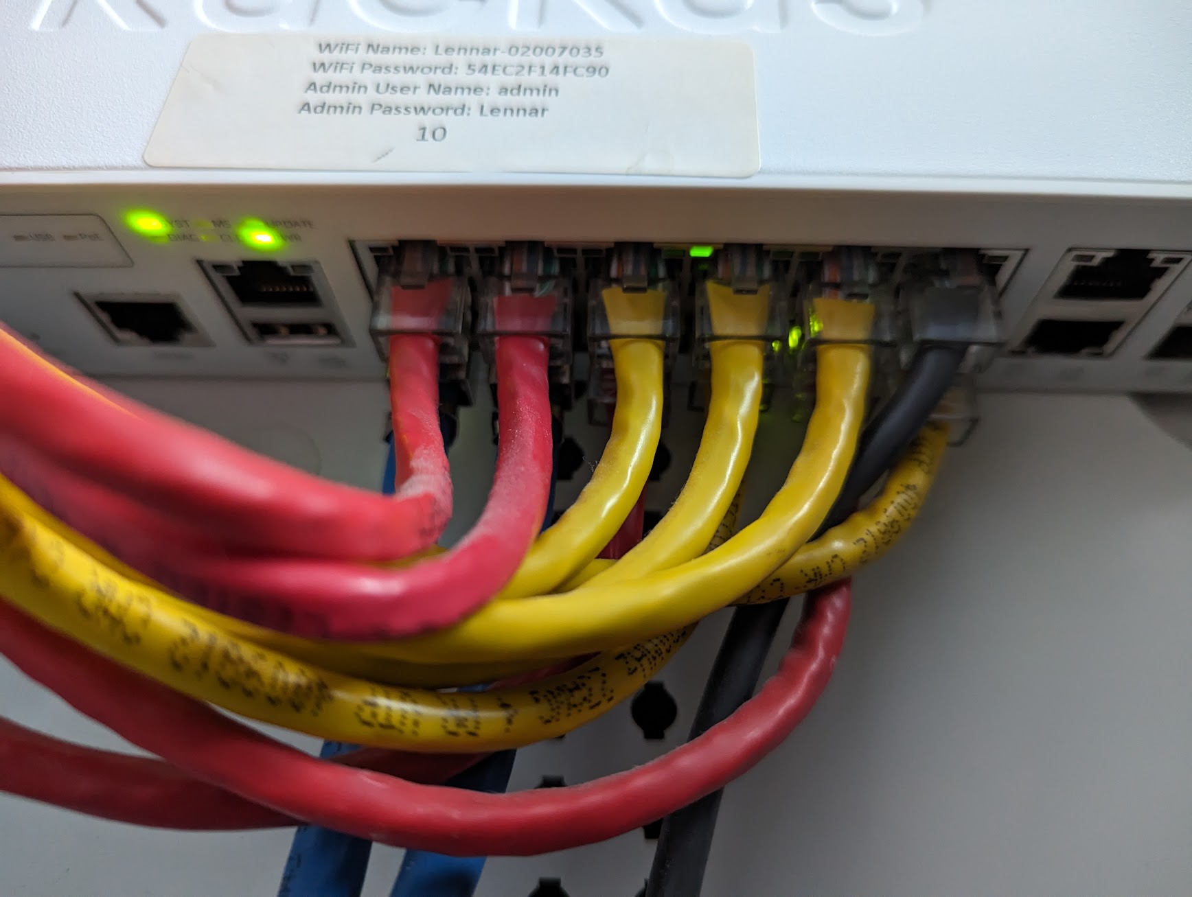

Ruckus ICX 7150-C12P
AP Upstairs
AP downstairs

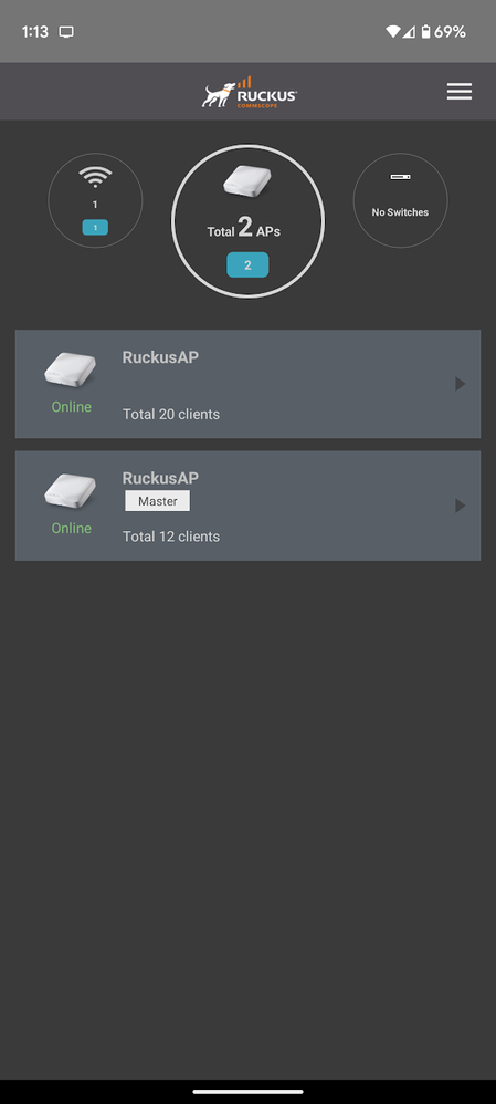

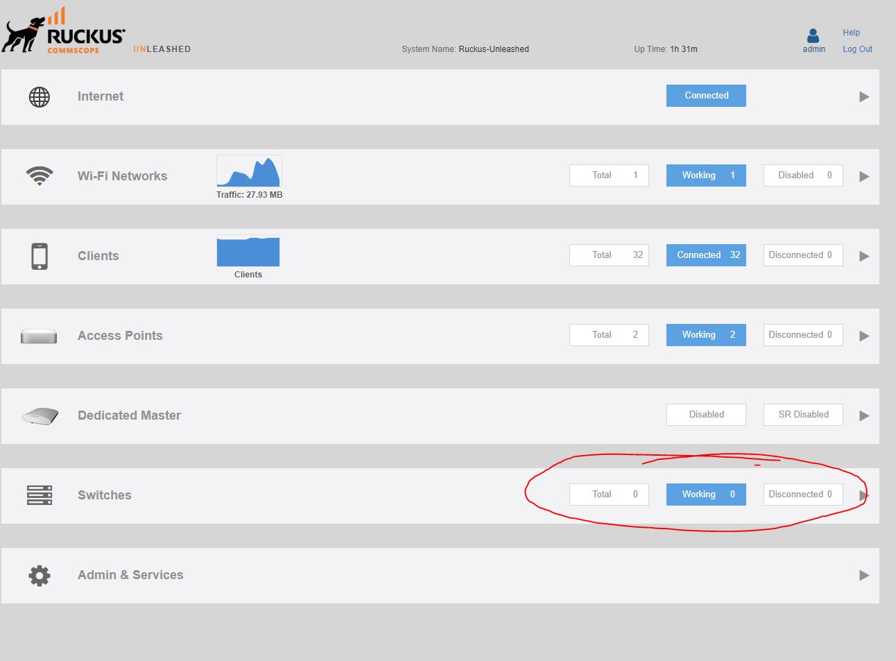

I am able to hit my ruckus system using its ip address to get to Ruckus Commscope on my desktop pc chrome browser and it is showing 0 working switches, can this be a cause of the issue?? Here is a screenshot.
Here is also a screenshot of the android app showing no switch

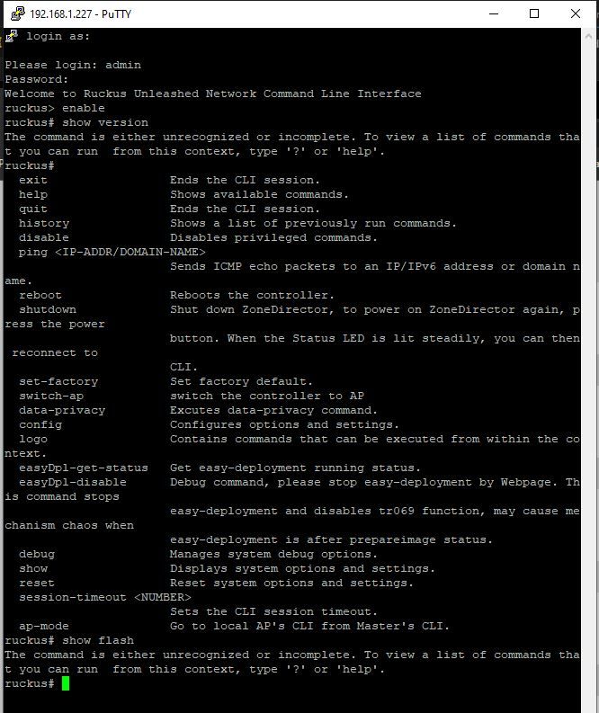

I have tried the above steps and was able ot get in but when trying to show version or showflash this it what it shows. I tried it two different types
first try
2nd try

Hi @yeahdawg
The command prompt is “ruckus>” on CLI meaning You are using Access Points IP address to access the CLI. Please run an IP scan once again and find the Switch IP Address.
As mentioned already, try to access your switch from a web browser by pasting the below URL in HTTP or https form whichever that works.
Once you confirm the Switch IP Address, please try to access the CLI as mentioned in the other guide from the last post and help us with the command outputs.
If you can access the CLI, the command prompt should look like below:
ICX7150-C12 Router> OR
ICX7150-C12 Switch>

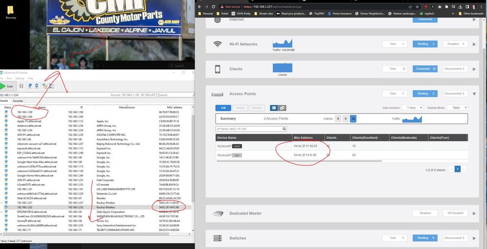

Hi Irman, The switch is not even showing up in the advanced IP scanner, only the APs are. See screenshot.
I have also tried accessing the other two ip address that start with 192.168.1 but no luck. This leads me to believe that their is something wrong with the switch? Even though we are getting internet access.
