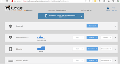

My GUI shows different than what it shows in the screenshots:
My GUI looks like this
Please guide me where I can see the below steps written in the documentation:
https://community.ruckuswireless.com/t5/RUCKUS-Lennar-Support-Knowledge/Title-Fixing-RUCKUS-ICX-7150...
My GUI doesnt show as in above image. Please let me know how to fix the routing code.

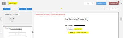

Please follow the below steps to find the switch GUI. 1: Find the IP address of the ICX7150 Switch.
If you have access to the Unleashed control panel it may appear under the Switches TAP, here you can see that the IP address of the Switch will be 192.168.1.3, of course this will change.
If it is not shown, or you do not have access to the Unleashed control panel, please follow the following guide to find the IP address of the Switch the name may look like ICX7150-C12-router, normally the name should be switch, but we have the problem about the routing code, making the Switch boot from the routing partition(secondary).

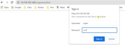

2: Now that you know the IP address of the Switch, in my case my IP address is 10.176.192.100, search for that IP address in the URL bar of your Web browser:
Hit login and the credentials must be
User: super
Password: sp-admin
Or test the combination
Usernames:           Passwords:
admin                    sp-admin
super                     Lennar
                               lennar
                               ruckus
                               Ruckus!
                               Ruckus1
                               admin
                               password

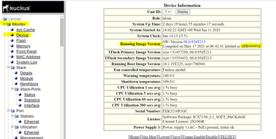

3: Now that you have access to the Switch, let's check what you have in flash, and from which code your Switch is booting.
A:Check what you have in the flash:
click on Monitor on the left > Flash > Flash Information
B:Check from which partition are you booting:
click on Monitor on the left >device

I followed the above 3 steps.
I got my IP.
I enter it in my URL as shown in the below image:
I dont see the points A, B.
