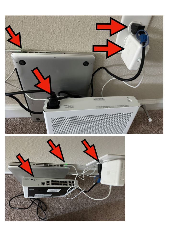

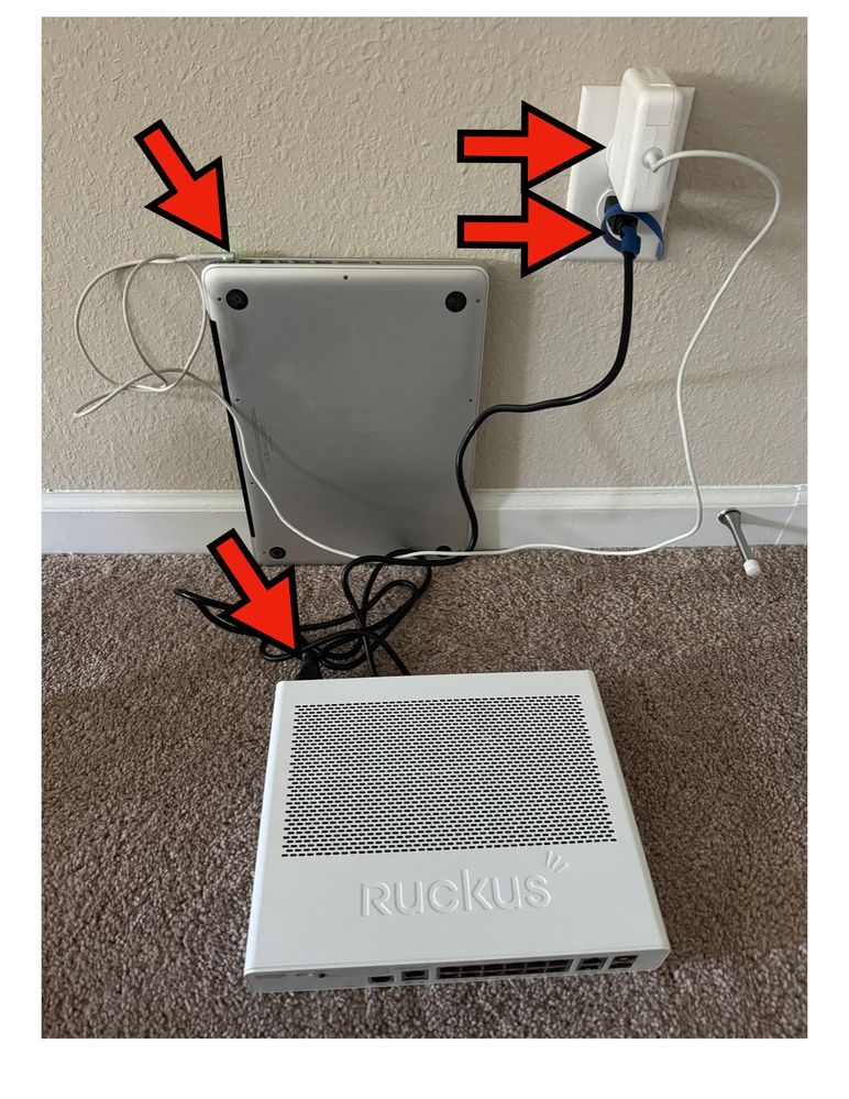

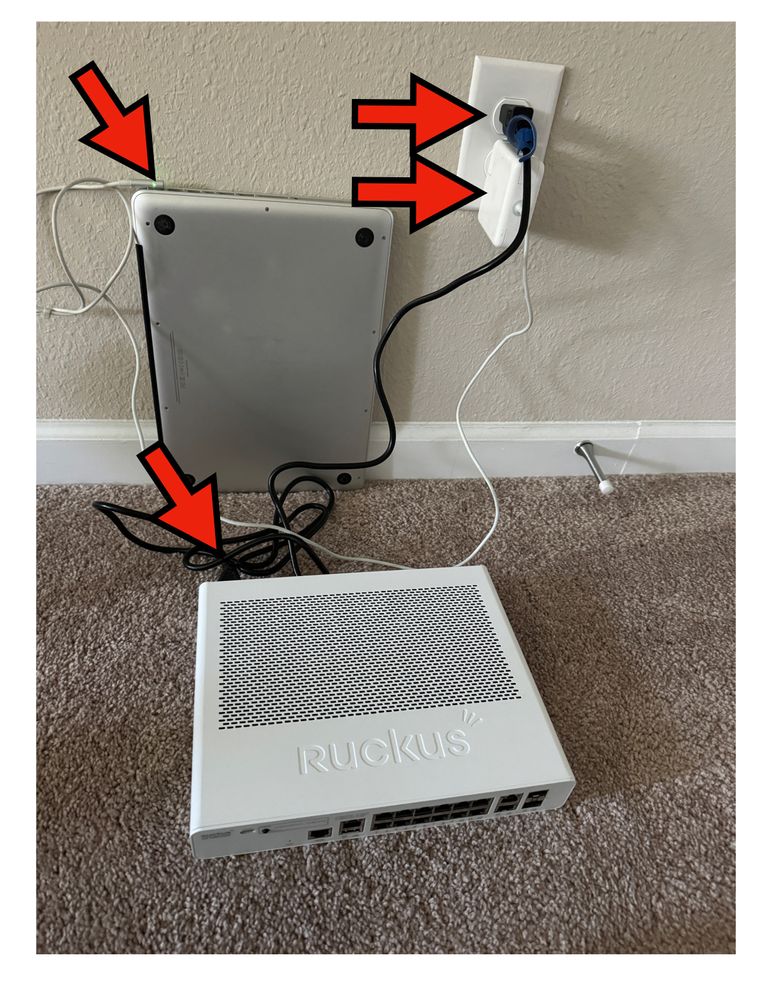

Could you please plug your ICX-7150-C12P Switch into a working power outlet and send us PICTURES and VIDEO of it showing the light status, and cord connected to the Switch and a working power outlet? Please refer to the below pictures as an example.
02-21-2024 06:44 AM
The still shots are attached and the video has been uploaded to the Google Drive link you provided. You now have pictures and video of the unit showing the light status, cord connected to the switch and a working power outlet as indicated by the power light on the other device plugged into the same outlet. Your pictures were used as the template for these photos to make certain everything you’ve requested is included. Thank you.
02-21-2024 07:18 AM
Hi @LennarRuckusGuy
Greetings of the day!!!
Thank you for sharing the requested PICTURES and a VIDEO.
Based on the troubleshooting done, your ICX-7150-C12P Switch is not powering up, and when plugged in, it flashes an amber light and then goes dark. And you confirm that the Switch is plugged into a well-known outlet/power source. However, the failure persists. This Switch unit Should be RMA (Return Merchandise Authorization) in simple words replacing it.
