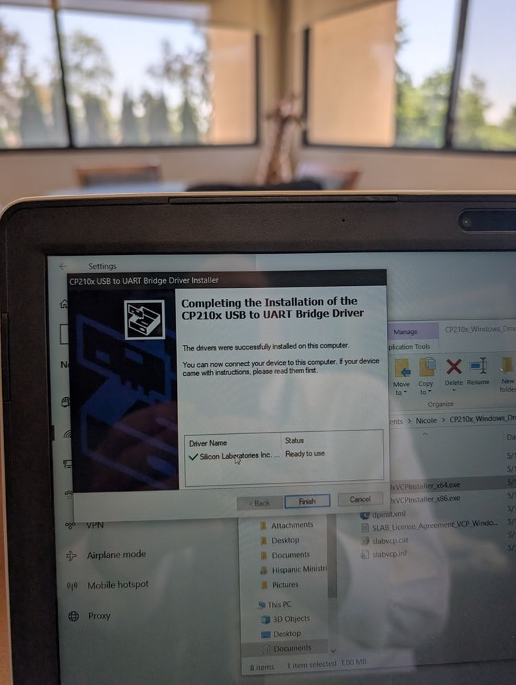

Ok Thanks. I want to make sure there is only one software we need to download to be able to console with the switch. There are always to links provided in the directions, but the drivers seem to be the same. Just want to make sure. I am attaching a picture of what I have done so far which seems to show I have installed the software correct.
05-21-2025 08:25 AM
Well unfortunately the downloads do not seem to be working. I could not connect to the switch. So I did a reset, which I did see the IP address for the switch, but when I logged into the wireless site, it still was not connected there. I unplugged the switch and have brought it to work to my IT people and he is going to look at it today. He is familiar with your product and we use some switches in the building as well. I will keep you updated on what happens.
