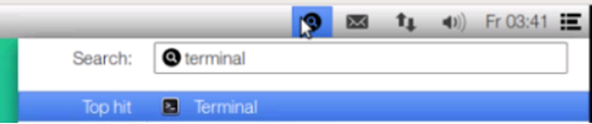

05-19-2025 10:20 AM
Hi @Timyee19
If you have a MacBook, then
Open Terminal >> Then type "ssh [email protected]" (admin in the command is the Unleashed Username)
Then enter the password.
Screenshot:
Let me know how it goes.
