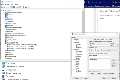

1. Please make sure to download the zip drive for the file below & "extract all". Once it's extracted, run the file, the driver should be installed using the 2 links below.
Link 1: https://support.ruckuswireless.com/software/1414-brocade-ruckus-7150-usb-serial-driver-windows
Link 2: silabs.com/developers/usb-to-uart-bridge-vcp-drivers?tab=downloads
Once installed restart your laptop and try to locate the COM port details under 'Ports (COM & LTP)' with cables connected between the Laptop and the Switch (Refer to the below screenshot), Please check and let me know if that works.

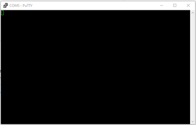

I have downloaded the drivers and I am connected to the COM port. When I connect through PuTTY, I get this screen.
No response in the console. I restarted my computer prior to moving to the next steps.

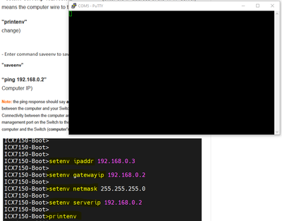

The link for the TFTP server no longer works. I downloaded a different TFTP server to get started, but when I went back to PuTTY to start the process of loading I still get the blank page where I should get the below.

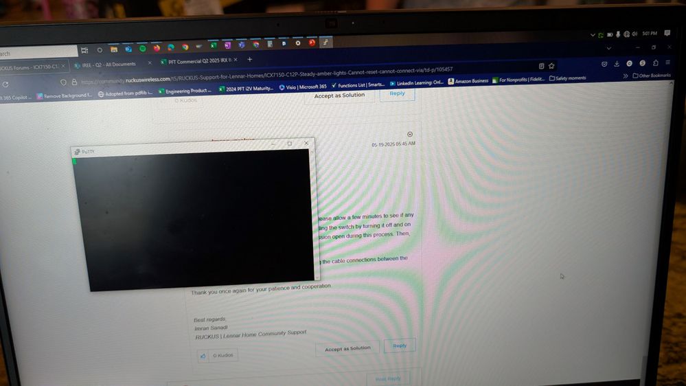

When the PuTTY screen for COM5 appears blank, please allow a few minutes to see if any output is displayed. If nothing appears, try power cycling the switch by turning it off and on from the power outlet, keeping the PuTTY COM5 session open during this process. Then, check again for any output.

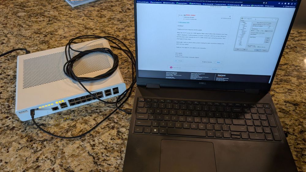

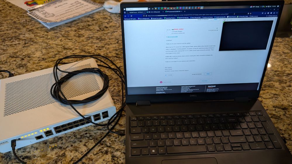

Additionally, could you please share a photo showing the cable connections between the switch and your laptop?
5pm interconnection5pm interconnection5:16pm rebooted and still no COM communication5:16pm rebooted and still no COM communication5:16pm rebooted and still no COM communication5:16pm rebooted and still no COM communication5:01PM PuTTY COM Connection5:01PM PuTTY COM Connection5:15pm with power disconnected5:15pm with power disconnected5:01PM PuTTY COM Connection5:01PM PuTTY COM ConnectionAfter the 5:16 picture I left the computer connected to the switch and the COM session open. It never changed on the screen.
