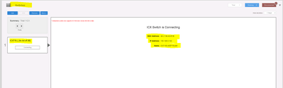

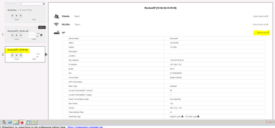

07-31-2023 02:05 PM
Hi @hjkim1187
Thanks for your response.
Please try to login to the unleashed system in web browser as mentioned below and share the status of the switch and access points in the unleashed dashboard as mentioned below.
