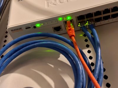

3. On your switch while it's plugged into the outlet, do you see any lights on? (Amber or green) Please let us know which lights are on. (Please refer to the below picture and share a picture of the same, showing the light status and the FULL Switch panel cable connections to the Switch ports)
4. Is your Internet Connection from the Internet Service Provider (ISP) stable and working? (You could check this by connecting to your local router Wi-Fi or from an ethernet cable from the Router to a laptop/PC).
5. May I know how many Access Points are connected to the Switch? Could you please let me know the light status on the Access Points? Any of these lights are on (Please refer to the below picture and share a picture of the same)

Hi @rawtallents
Is the orange cable the one that is connected to your ISP??
All cables should be plugged into the 12-port panel.
4. Is your Internet Connection from the Internet Service Provider (ISP) stable and working? (You could check this by connecting to your local router Wi-Fi or from an ethernet cable from the Router to a laptop/PC). The connection to ISP is working fine.
5. May I know how many Access Points are connected to the Switch? Could you please let me know the light status on the Access Points? Any of these lights are on (Please refer to the below picture and share a picture of the same) 2 access points with the same lights.
