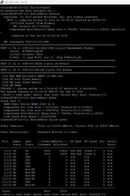

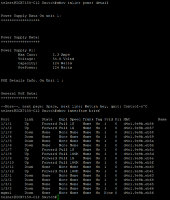

If this doesn't work, please use a personal laptop and try accessing CLI.
Hello. Below is what is shown in CLI.
Hello @jharr11 ,
Thank you for sharing the screenshots.

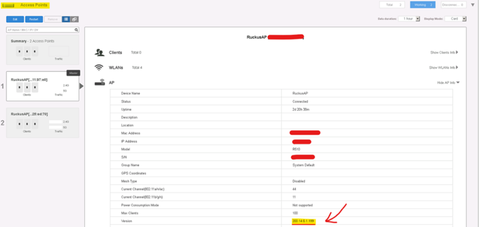

Could you please log in to your Unleashed system on a LAPTOP WEB BROWSER using the   AP IP Address OR https://unleashed.ruckuswireless.com/ ?
Please make sure you are connected to the RUCKUS Wi-Fi Network to access the same.
If you can’t access using the above link and don’t know the IP Address of the Access Points. Please refer to the below guide to find the IP Address of the Access Point to get the requested information.
How to find the IP Address of the RUCKUS Devices (Switch and APs) using IP Scanner free applications
You should see the below-Unleashed dashboard after finding the IP Address of the AP. Try to log in
Please check the current version of your Unleashed Access Points and share a screenshot of the same.
Please refer to the below screenshot for more information on how to know your Unleashed Access Points version details.
Please help us with the above requested information and let us know if you have any queries in this regard.
