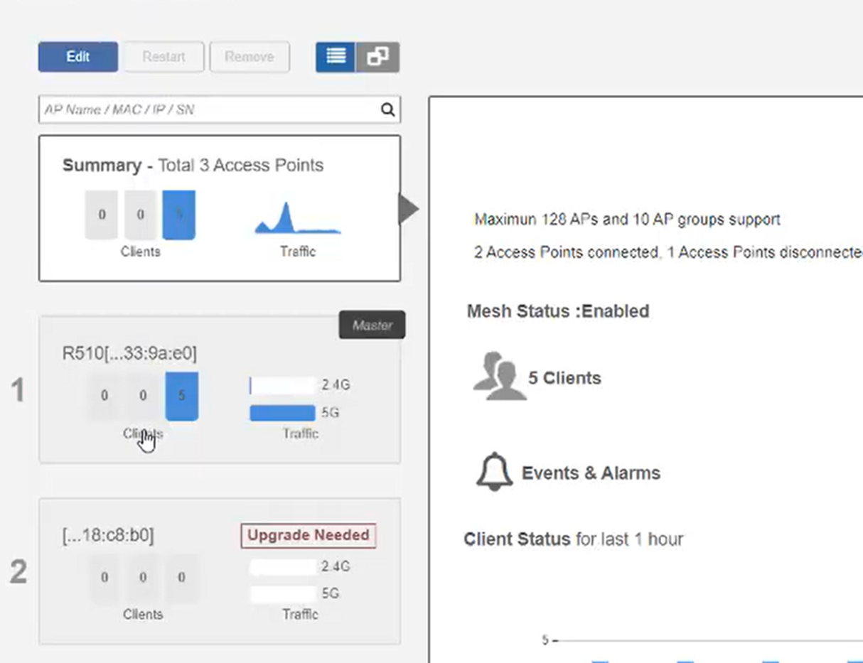

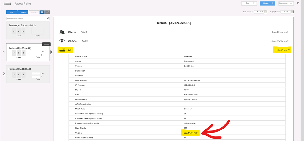

Please check the current version of your Unleashed Access Points and share a screenshot of the same.
Please refer to the below screenshot for more information on how to know your Unleashed Access Points version details.

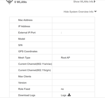

Masni
Hi Pinky -
Here's a screenshot from the dashboard: it does not have any information regarding the AP version. I't just blank. Is there another way I can retrieve the information?

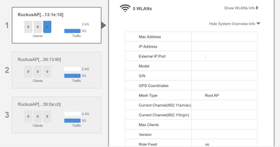

Hello @Masni ,
I would request you to please select one of the AP s from the side tool bar and check the AP version details as referred in the screenshot from the previous post.
Please select AP to find the Version details.
Hi Pinky -
That's exactly what I did. I selected one of the APs (the Master AP) but there's no information about the version. See another screenshot with the AP selected
