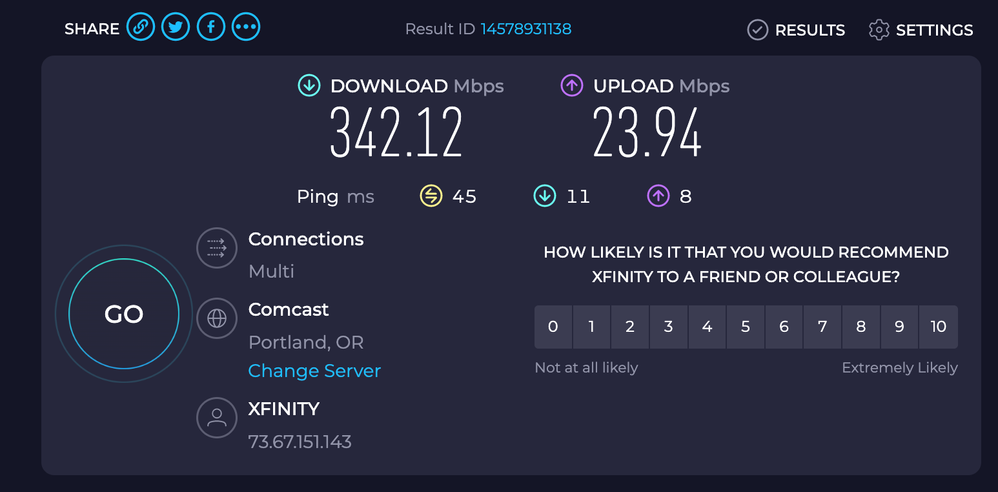

04-06-2023 09:31 AM
I checked both the modem and switch. The modem speed is attached, the switch has no internet, the speed tester failed saying no connection.

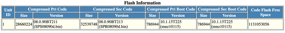

04-06-2023 12:19 PM
04-06-2023 12:52 PM
Hi @Mohitgahlot14
Seems like your Switch is booted on the secondary partition which is running on Routing Code (SPR) as marked in the below screenshot.
Could you please let me know if you have CLI access to the Switch as described in my previous post? If yes, please perform the below commands in CLI.
ICX7150-C12 Router>
Here is a quick guide for understanding how to fix the 'routing code issue' however, you only need to run the following commands once you are on the command line 'CLI'
show version
copy flash flash secondary
Example:
VIDEO LINK AS REFERENCE: https://www.youtube.com/watch?v=Eem1IBgYaWc
ICX7150-24P Router#copy flash flash secondary (hit enter to accept the command and wait: until the flash finished)
ICX7150-24P Router#boot system flash secondary yes (hit enter to accept the command: the switch will reboot)
