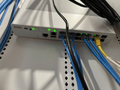

My both APs stopped working, it seems like switch has some problem. How can I replace it?

2. On your switch while it's plugged into the outlet, do you see any lights on? (Amber or green) Please let us know which lights are on. (Please refer to the below picture and share a picture of the same)

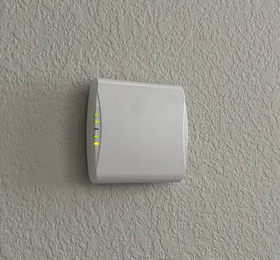

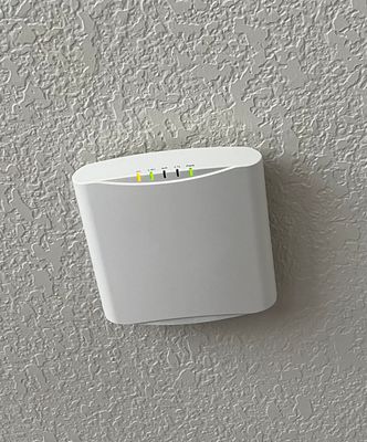

4. May I know how many Access Points are connected to the Switch? Could you please let me know the light status on the Access Points? Any of these lights are on (Please refer to the below picture and share a picture of the same)
Please help us with pictures of your ICX-7150-C12P Switch showing the status of the lights. Also, light the status of Access Points.
Yes, see attached pictures
2, see attached pictures
04-05-2023 09:40 AM
Hi @Mohitgahlot14
May I know from where the yellow ethernet cable is coming? (Please refer to the below screenshot)
Thank you again.
Lennar Home Community.
04-05-2023 09:40 AM
Modem
