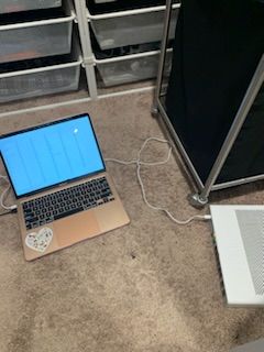

Had a power surge and Ap went down. Did a power cycle and a factory reset and that did not do anything. Even tried to console in and recover software, but could not get that to work. Just need to RMA the device and get a new one set up. Any recommendations on fixing the issue if a power surge happens?

Attached should be the photos

Hi @MikeyH
Basically if the switch has one green and one yellow light, it means that the switch is stuck in boot mode.
  1. Remove power from the switch.
If this step doesn't work, we need to perform a software recovery.
Here is the quick guide to perform software recovery.
Note: after fixing the issue of the Switch been stuck in boot mode, please perform an upgrade to the code 08095g UFI and upgrade both partitions with the switching code file named SPS08095gufi.bin, so perform the software recovery using the code 08090k with the upgrade image file named SPS08090k.bin, then when the switch is back to normal upgrade to the file SPS08095gufi.bin for both partitions primary and secondary.
