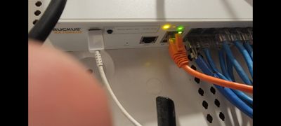

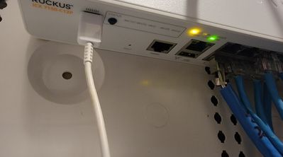

Hi, My switch is ICX 7150-C12P. Again after power outage, It is showing Amber/Orange light on "SYST" and Green light on "PWR" & NO lights on APs. I have tried to reset, while powering on. It keep stuck at booting with orange lights flashing. I'm tired of doing restarts. followed all the steps from NO Power on Access Points and ICX-7150-C12P Switch with GREEN lights on SYST & PWR and PoE disabled.  Nothing worked, never get response from switch.

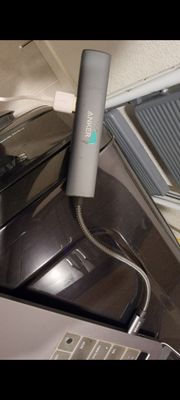

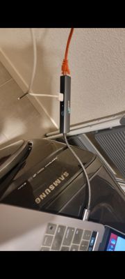

We apologize for any inconvenience, but to proceed further, we require a visual representation. Kindly assist us by providing a picture demonstrating the proper connection of the software recovery cable between the switch and the laptop.
It's imperative to utilize an ethernet cable (both ends RJ45 plugs) in conjunction with a USB to type C cable, as specified in steps 2 & 3 of the provided guide.

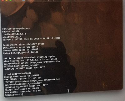

Thanks for the pic, Same issue screenshots below.

Hello @Nishanthm
Thank you for your response and the information provided.
Upon reviewing the picture, it appears that only a USB to Type-C cable was used. However, it is essential to have an Ethernet cable connected between the Switch management port and the Laptop/PC, as depicted in the screenshot provided.
Kindly ensure that both an Ethernet cable (with RJ45 plugs at both ends) and a USB to Type-C cable are used simultaneously, following the steps outlined in steps 2 and 3 of the guide link. I kindly request that you perform the software recovery process again according to these specifications. Additionally, please share any screenshots of errors encountered during this process.
