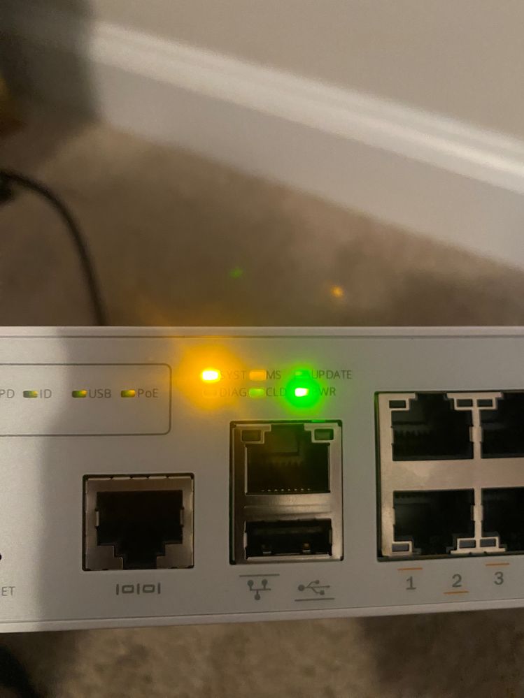

Hello, all lights on my Ruckus ICX 7150 are blinking after performing the following steps over 20 times:
  1. Remove power from the switch.
17 REPLIES 17

  1. Was there any power outage before you started facing this issue?
  2. On your switch while it's plugged into the outlet, do you see any lights on? (Amber or green) Please let us know which lights are on. (Please refer to the below picture and share a picture of the same, showing the light status and the FULL Switch panel cable connections to the Switch ports)

Thank you for the reply. To answer your questions, yes there was a power outage. 2, the system light is amber and the power light is green, these are the only two lights on when I plug in the device. When I follow the steps to reset the device all of the lights blink non-stop. Please see photo below. ruckus.jpg
pinky_ruckus
Valued Contributor III
Hello @deeguyon ,
From the pictures you shared, I understand that the status lights on the Switch is Amber and the PWR light is Green, which means that the Switch is stuck in a boot mode.
Please follow the below RUCKUS Lennar Knowledge base self-help article which will help you to fix the issue when the Switch is in boot mode.
https://community.ruckuswireless.com/t5/RUCKUS-Lennar-Support-Knowledge/Fixing-RUCKUS-Switch-with-an...
Please follow the process as explained in the article and let me know if you have any queries in this regard.
