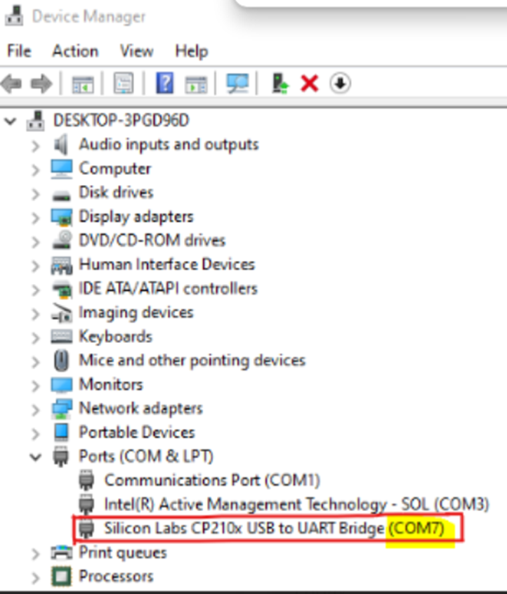

Also, please share the screenshot of the COM port details. COM port details should be with the silicon lab name in the device manager.
I would request you to please check if both the drivers are installed as per the software recovery article.
Once again, please make sure to download the zip drive for the file below & "extract all". Once it's extracted, run the file, the driver should be installed using the 2 links below.
Link 1: https://support.ruckuswireless.com/software/1414-brocade-ruckus-7150-usb-serial-driver-windows
Link 2: silabs.com/developers/usb-to-uart-bridge-vcp-drivers?tab=downloads
Could you please restart the laptop after installing the drivers and check the COM port details in the Device Manger from the Control Panel?
