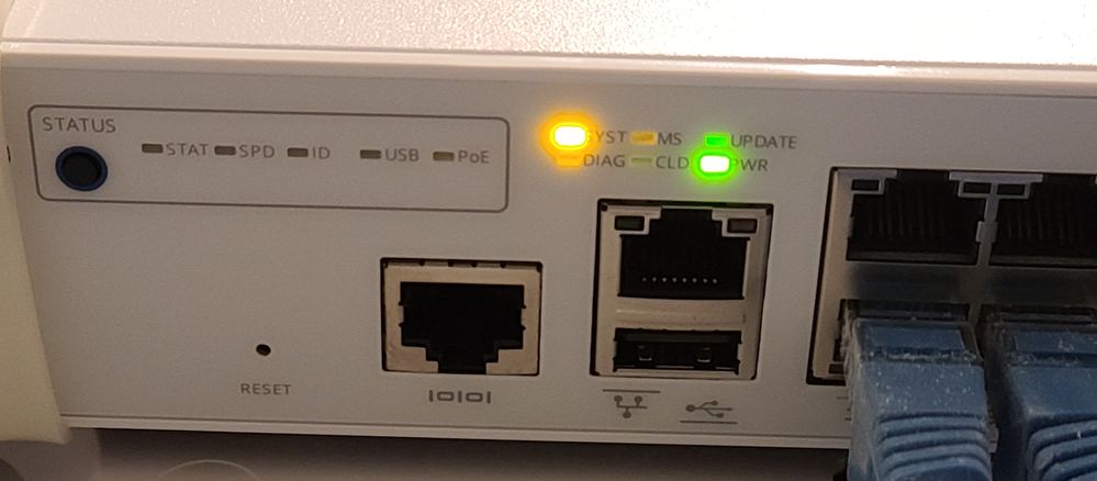

Please see attached pic for clarity.
The system light is amber. And power light is solid green. No lights in all 5 ports.

Hi @FOTV
Based on your description, it seems that your switch has one green and one amber light, which means that the switch is stuck in boot mode.
  1. Remove power from the switch.
If the resetting process doesn't work, we need to perform a software recovery.
Here is the quick guide to perform software recovery.
Note: after fixing the issue of the Switch been stuck in boot mode, please perform an upgrade to the code 08095g UFI and upgrade both partitions with the switching code file named SPS08095gufi.bin, so perform the software recovery using the code 08090k with the upgrade image file named SPS08090k.bin, then when the switch is back to normal upgrade to the file SPS08095gufi.bin for both partitions primary and secondary.
