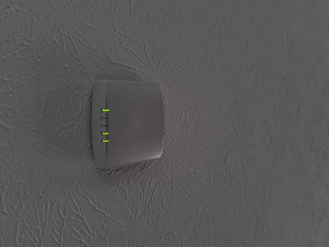

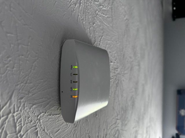

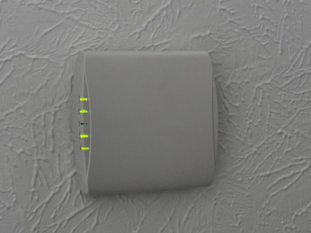

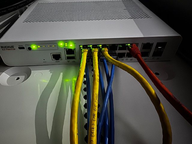

  2. Please refer to the below picture and share a picture of the same, showing the light status and the FULL Switch panel cable connections to the Switch ports)
      3. aMay I know how many Access Points are connected to the Switch? Could you please let me know the light status on the Access Points? Any of these lights are on (Please refer to the below picture and share a picture of the same)

Hello @Davepd3 ,
Thank you for the response and the information shared.
Upon checking the light status, we see that everything looks good with the Switch and the AP. At this point, we suggest you to  perform a factory reset on the access point and establish a new Wi-Fi network/SSID.
