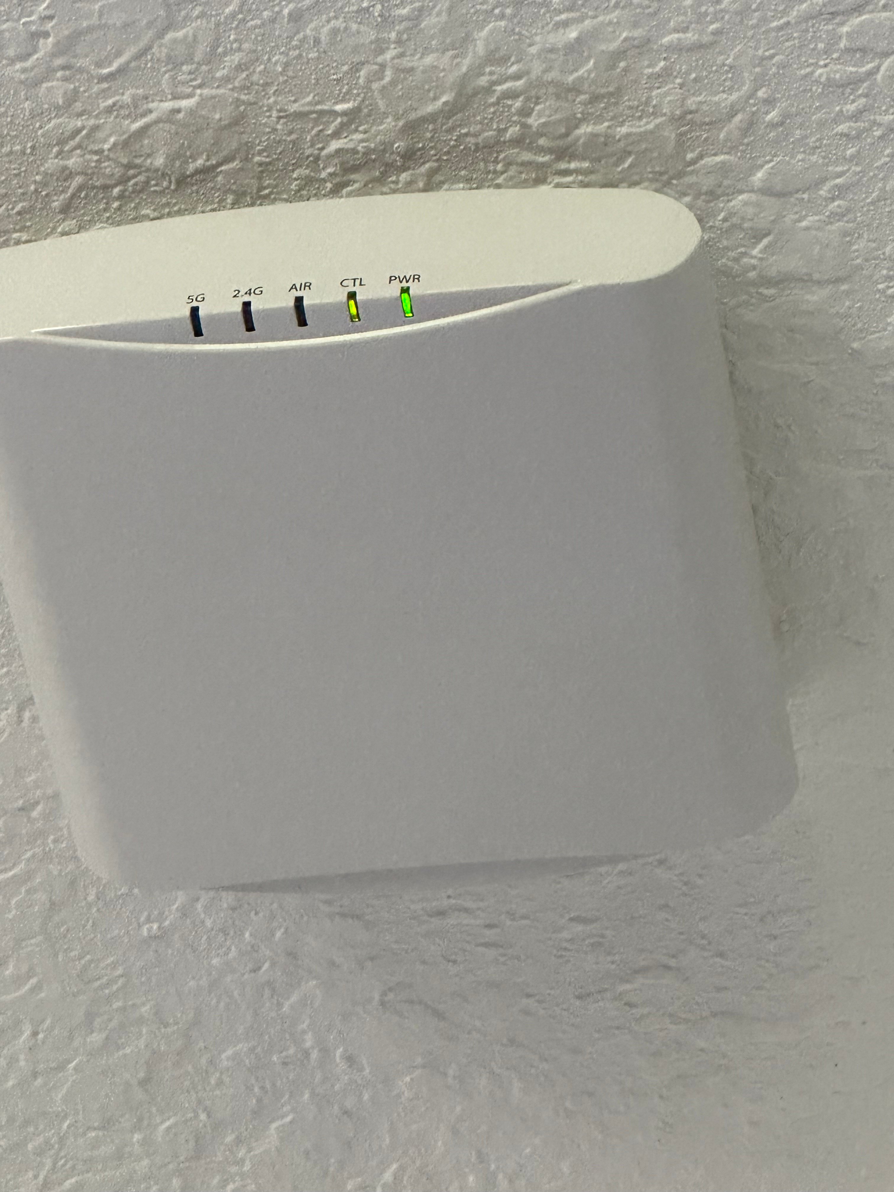

Internet is out due to power outage. Tried hard reboot of ruckus icx7150-c12p with no luck. Also checked access point cables to laptop - no connection. Followed instructions for CLI.
right now, one access point is blinking slowly for PWR and CTL. The other access point is blinking green slowly for PWR

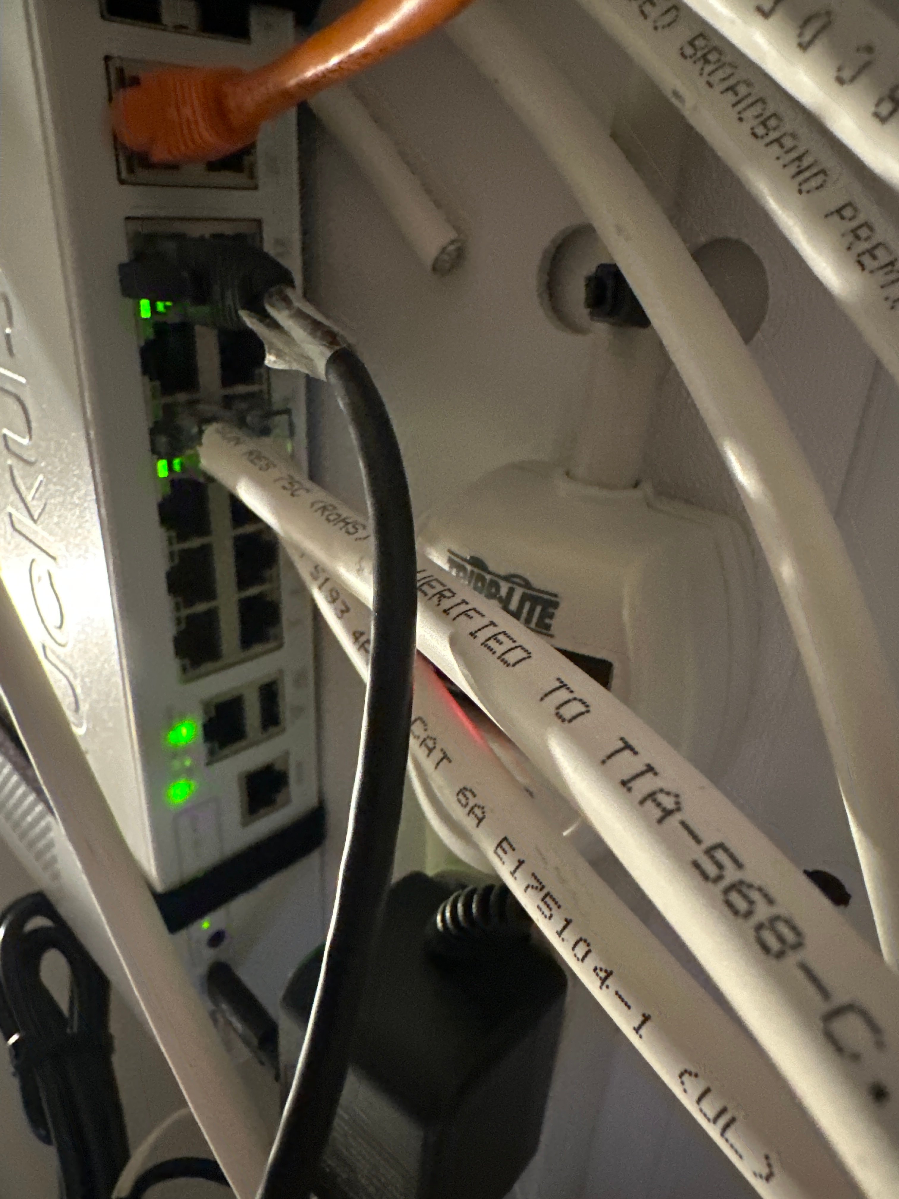

Hello @Micsan352 ,
As per the case description, I understand that your RUCKUS setup is not working after the power outage.
From the pictures you shared, it seems like the ethernet cable which is coming from the ISP’s (Internet Service Provider’s) Router or Modem/Router combo is plugged into the wrong port on the Switch panel. It must be plugged into any 1 in-12 ports as shown in the below screenshot. Please unplug the ethernet cable and plug it into the correct port then reboot (unplug and plug from the power outlet) and try to connect to the Internet via Access Points.
It should be plugged into one of the 12 ports as shown in the below screenshot.
07-16-2024 09:10 AM
Thank you. The solution worked. What can I do to ensure the hardware/firmware is updated. Any app I can download?
