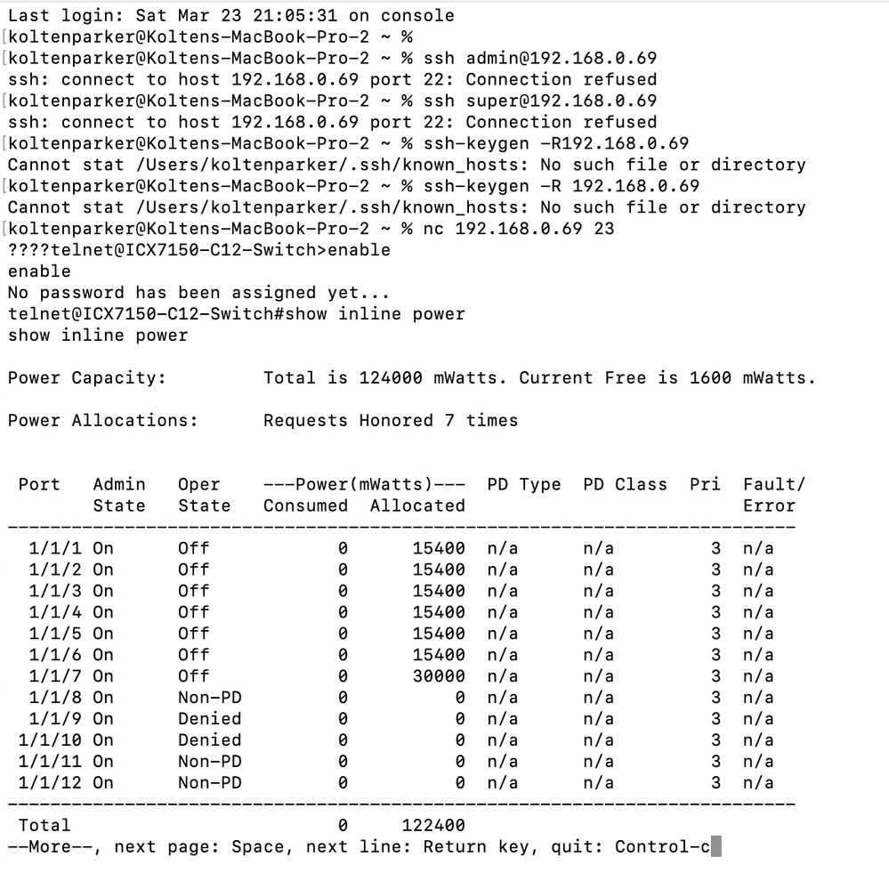

Hello, once you noted that the device could be Brocade Communications, I saw it on the LAN scan. With the IP address identified, I accessed the CLI and was able to check on the ports. They are in the ON state. Please see screenshot.
What should I do next?
Please note: I alsoScreenshot 2024-04-08 at 2.37.06 PM.png attempted to login through my browser to the IP address, but it would not accept any credentials (including the credentials I use to login via the Ruckus Unleashed mobile app and the default passwords listed in the knowledge base).
Hi @koltenp
Please enter the below commands and try once if they powers up.
Switch>enable
Switch#configure terminal
Switch(config-mif-1/1/1-1/1/12)#no inline power (please wait till the process gets complete)
Switch(config-mif-1/1/1-1/1/12)#inline power (please wait till the process gets complete and check)
