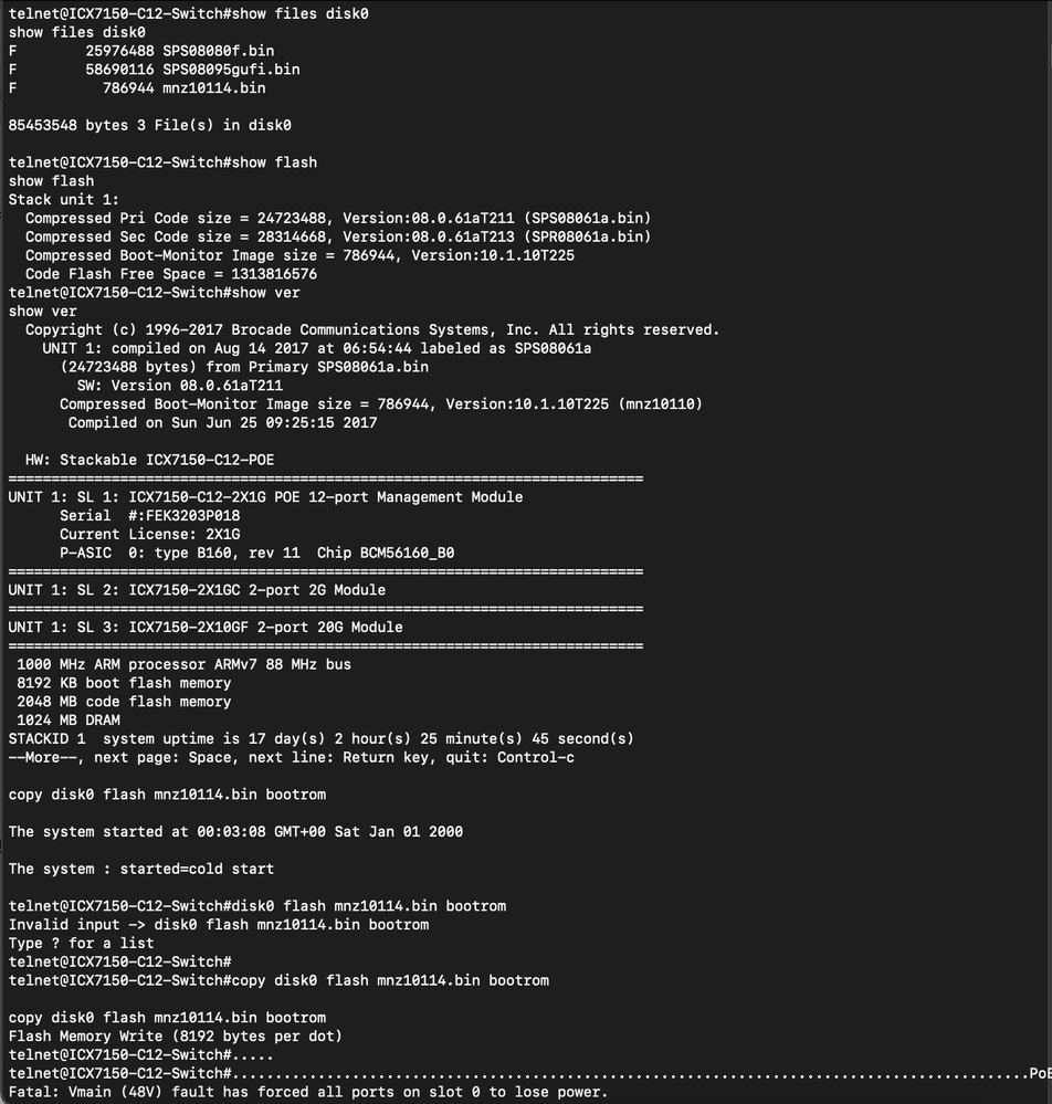

04-10-2024 07:01 PM
Using option 2 I was able to make it to step 17. But then I got the following error message:
"Fatal: Vmain (48V) fault has forced all ports on slot 0 to lose power."
Please see screenshot and advise.

04-11-2024 01:09 PM
When I attempt to connect to the switch via CLI using this prompt, I get the same error message dozens of times.
"koltenparker@Koltens-MacBook-Pro-2 ~ % nc 192.168.0.69 23
????telnet@ICX7150-C12-Switch>PoE Fatal: Vmain (48V) fault has forced all ports on slot 0 to lose power."
I cannot enter any other commands without getting the exact same error message. Are you able to remote in to my laptop and solve the issue?

04-11-2024 01:18 PM
Hi @koltenp
Thank you for the response and for sharing the details.
Based on the troubleshooting done, your ICX-7150-C12P Switch PoE ports are not working and are unable to transmit power. we tried to enable the PoE ports using CLI commands with no success. When we tried to upgrade the Switch to a stable version, there was an error ‘Vmain (48V) fault has forced all ports on slot 0 to lose power’. The failure persists and it's the hardware issue. This Switch unit Should be RMA (Return Merchandise Authorization) in simple words replacing it.
