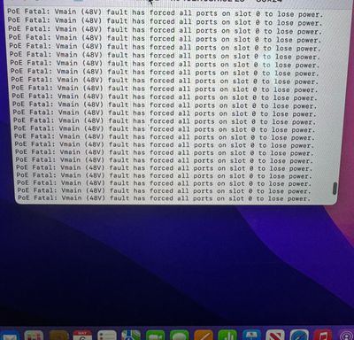

Our access points went blank. Not sure when or how. There’s no lights on the one upstairs or downstairs. The main ruckus box shows green lights (none amber). Because of this, things like the downstairs thermostat, ring doorbell and other things are not working either. There’s also a black box named kevo that is not working. We tried resetting, unplugging and plugging back. Nothing seems to work. I have never touched these boxes for anyhting before and I don’t understand them. Please help…

I am getting this message after message on terminal “syncing image to flash. Do not switch over or power down the unit (65536 bytes per dot)…”

Based on the troubleshooting done, your ICX-7150-C12P Switch ports are not working. We tried to enable them from the CLI with no luck. When tried to upgrade the Switch there is PoE fatal error which is a indication of the corrupt kernal of the Switch and a hardware issue. This Switch unit Should be RMA (Return Merchandise Authorization) in simple words replacing it.
Mel
