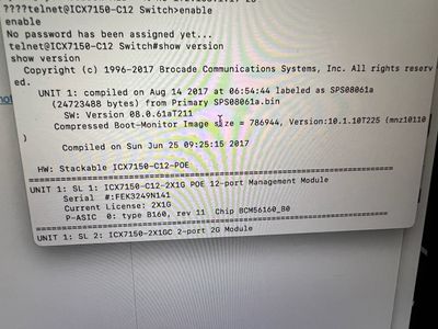

????telnet@ICX7150-C12 Switch>enable
telnet@ICX7150-C12 Switch#show version
show version
Copyright (c) 1996-2017 Brocade Communications Systems, Inc. All rights reserved.
UNIT 1: compiled on Aug 14 2017 at 06:54:44 labeled as SPS08061a
(24723488 bytes) from Primary SPS08061a.bin
SW: Version 08.0.61aT211
Compressed Boot-Monitor Image size = 786944, Version:10.1.10T225 (mnz10110)
Compiled on Sun Jun 25 09:25:15 2017
HW: Stackable ICX7150-C12-POE
Serial #:FEK3249N141
Current License: 2X1G
8192 KB boot flash memory
2048 MB code flash memory
1024 MB DRAM
STACKID 1 system uptime is 12 hour(s) 49 minute(s) 0 second(s)
--More--, next page: Space, next line: Return key, quit: Control-c

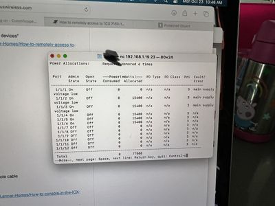

telnet@ICX7150-C12 Switch#show inline power
show inline power
Power Capacity: Total is 124000 mWatts. Current Free is 47000 mWatts.
Power Allocations: Requests Honored 6 times
Port Admin Oper ---Power(mWatts)--- PD Type PD Class Pri Fault/
State State Consumed Allocated Error
1/1/1 On Off 0 0 n/a n/a 3 main supply voltage low
1/1/2 On Off 0 15400 n/a n/a 3 main supply voltage low
1/1/3 On Off 0 15400 n/a n/a 3 main supply voltage low
1/1/4 On Off 0 15400 n/a n/a 3 n/a
1/1/5 On Off 0 15400 n/a n/a 3 n/a
1/1/6 On Off 0 15400 n/a n/a 3 n/a
1/1/7 Off Off 0 0 n/a n/a 3 n/a
1/1/8 Off Off 0 0 n/a n/a 3 n/a
1/1/9 Off Off 0 0 n/a n/a 3 n/a
1/1/10 Off Off 0 0 n/a n/a 3 n/a
1/1/11 Off Off 0 0 n/a n/a 3 n/a
1/1/12 Off Off 0 0 n/a n/a 3 n/a
Total 0 77000

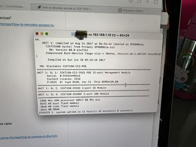

ICX7150-C12#show inline power detail
filtering...
telnet@ICX7150-C12 Switch#show inline power detail
Power Supply Data On unit 1:
Power Supply Data:
Power Supply #1:
Max Curr: 2.3 Amps
Voltage: 54.0 Volts
Capacity: 124 Watts
PoePower: 124 Watts
POE Details Info. On Unit 1 :
General PoE Data:

Hi @tbone550
Thanks for the information provided. I can see that the main switch is running a very old version; this version is known to have issues with PoE.
Our recommendation will be to update the unit to solve this problem.
Please follow the below steps explaining the Upgrade process.
The recommended stable version is 8095g (08.0.95g)
The Upgrade path must be 8061 to 8080f non-UFI to 8095g UFI OR 8095j UFI
>You will have to download 2 files (8080 and 8095) and do the process 2 times as well.
*NOTE*
*For versions 8080 you will find a file that is named Boot. There you will find the boot code and it should be uploaded before the image.
*For UFI versions, the boot code is embedded in the image so there is no need to upload the boot from the file.
*Please remember to use the image that says SPS
(PLEASE NOTE: Use 08095g patch in place of 80xx as explained in the guide)
