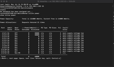

07-24-2023 05:55 PM - edited 07-24-2023 06:36 PM
EDIT- I thought I had it down but now all the lights are off again.
