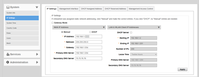

Please check your IP settings for the access point, is it set to DHCP or static? If it’s set to static IP, there could be an IP conflict, switch to DHCP and reboot AP. (Please refer to the below screenshot)
Reboot: for all the Access Points as shown in the below screenshot.

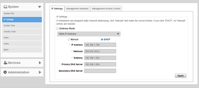

10-09-2023 03:48 PM
The IP Setting was already set to DHCP.
Heartbeat Loss issue remains.

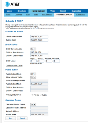

I had the same problem for several months and tried all the steps as advised by the support, including factory resetting the APs. However, none was a root cause. Fortunately, I found this article, which traces the problem to root AP renewing its DHCP address every 12 hours, which leads to Unleashed network being disconnected and rebuilt every 12 hours. All Ruckus Unleashed AP's Lose Heartbeat Simultaneously (kahuna-fi.com)
Based on this information, I tried to increase DHCP lease to longer period (it was 24 hours), but it did not help - it seems the Ruckus APs are auto configured to renew DHCP every 12 hours. Then I assigned the root AP to the static IP address outside my AT&T router DHCP range. I also configured Management IP as a static address as well, though I believe it was not necessary. Only root AP has a static address, other four APs in my home receive their addresses via DHCP. And it resolved the problem!!
