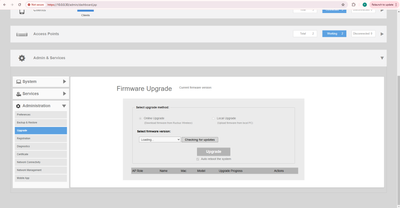

Hi Imran,
I went through your Knowldgebase link : https://community.ruckuswireless.com/t5/RUCKUS-Lennar-Support-Knowledge/Upgrade-process-of-the-RUCKU... for upgrading firmware of my access points, but neither of those 2 options i.e. Online upgrade nor Local upgrade work for me.
Here is the screen i see when i login to my Master AP from web browser:
For Online upgrade ( default selected option ) :
For Local Upgrade option, when I hover over this radio button option, I see a red circle with a red diagonal line in it, indicating that this radio button is also disabled ( i.e. not available for selection )

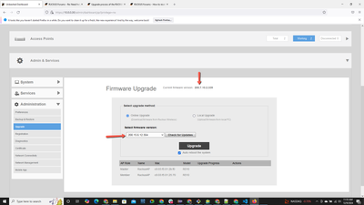

Hi Imran,
Yes i see both the upgrade options available when viewing my Master AP through Mozilla Firefox browser as seen below:
