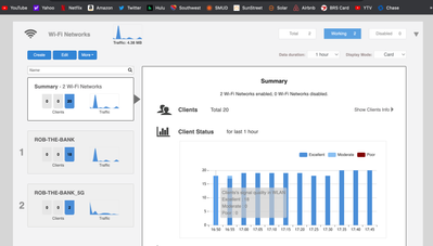

09-08-2023 08:28 AM
Hi @r_mendoza85
The dashboard you are seeing on the web browser is of ICX-7150-C12P Switch and not of the Unleashed system.
You should see the Dashboard as shown in the below screenshot to confirm it’s the Unleashed login.
Please try to browse unleashed.ruckuswireless.com or IP Address of the Master Access Point to get the Unleashed login dashboard.
Please log into the Unleashed, follow the steps shared in my previous post and let me know if you have any queries in this regard.

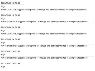

09-11-2023 06:00 PM
Hello,
Thank you for the clarification. I was able to set up the alternate network to isolate the 5G signal but the "Heartbeat Loss" issue persists.
The events log is attached and you can see this problem recurs every 12 hours consistently.
Any other recommendations?
