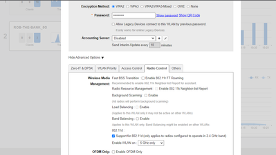

I made the suggested modifications and the issues remains. Continuing to occur ever 12 hours.
Screen grabs below and alarm log since the hard reboot of the Ruckus Switch and ISP Router.

Hi @r_mendoza85
Could you please, log into your unleashed system, and go to Services>Radio Control> Background Scanning? Uncheck the options or set them out further like 9000 seconds.
Then continue from here to Services>Radio Control> Client Load Balancing, Make sure those options are unchecked!
Once the above process is done, please reboot (Unplug and plug from the power outlet) your RUCKUS ICX-7150-C12P Switch and the ISP (Internet Service Provider) Router once.
Check the behavior once you follow the above steps and please confirm if you have the same issue or if it gets fixed.

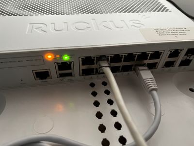

I made the requested change however now the switch’s SYSTEM light is amber and none of the AP are energized.
Hi @r_mendoza85
As I can see from the pictures you shared, there are lights on PWR and SYST, if there is an amber/orange light on the "SYST" and a green light on the "PWR" on the Switch (as it is in the below picture). Meaning the Switch is stuck in the boot mode.
Please note this is a different issue which is usually happens after the power outage/power spike. And this is NOT because of the changes you made on Unleashed.
Basically, due to the power outage/ power spike, the switch went to a state that we call ‘boot mode’ that is not able to boot up properly.
First, we will try to reset the Switch as described below:
  • Remove power from the switch.
  • Press and hold the Reset button while applying power to the switch.
  • After all the system LEDs flash amber, release the Reset button.
IF RESET IS NOT WORKING, PLEASE TRY TO RESET YOUR SWITCH MULTIPLE TIMES (Like 10-15 times) AS DESCRIBED ABOVE.
I rest the switch multiple times with no luck.
