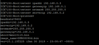

twmcc
OK, Not having any luck. My ping fails.
I have run both driver installs, CP210x_VCP_Windows and CP210x_Windows_Drivers.
My cables are USB-C, port #1 to USB on my computer and Ethernet to port #13.
When I look at the Device Manager I see Silicon Labs CP210x USB to UART Bridge (COM4)
That's all. No Intel Active Management Technology as shown in the procedure.
Here are my Environment Variables
Not sure what I am missing??
