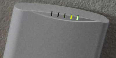

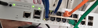

If that doesn't work, please share the below information:
1. Please provide a photo showing the status of the lights and the full switch panel with cable connections to the switch ports.
2. How many access points are currently connected to the switch? Please describe the status of the lights on the access points. Similarly, include a photo showing the access points' light status.

Herer you go still no lights on orange cable which goes to modem.
