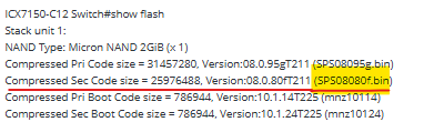

ICX7150-C12 Switch#show flash
Stack unit 1:
Compressed Pri Code size = 31457280, Version:08.0.95gT211 (SPS08095g.bin)
Compressed Sec Code size = 25976488, Version:08.0.80fT211 (SPS08080f.bin)
Compressed Pri Boot Code size = 786944, Version:10.1.14T225 (mnz10114)
Compressed Sec Boot Code size = 786944, Version:10.1.24T225 (mnz10124)
Code Flash Free Space = 1168273408

Hi @mrozone
I see your Secondary partition is still on the 08080f version. (Refer to the screenshot below)
Please copy the 08095g version on the secondary and check how it works.
Please enter the below commands to copy the image to the secondary.
copy flash flash secondary
Example:
VIDEO LINK AS REFERENCE: https://www.youtube.com/watch?v=Eem1IBgYaWc
ICX7150-24P Router#copy flash flash secondary (hit enter to accept the command and wait: until the flash finished)
ICX7150-24P Router#boot system flash secondary yes (hit enter to accept the command: the switch will reboot)
