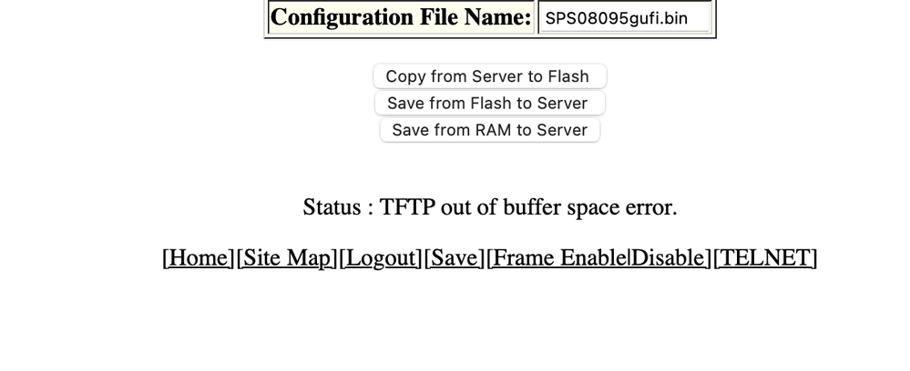

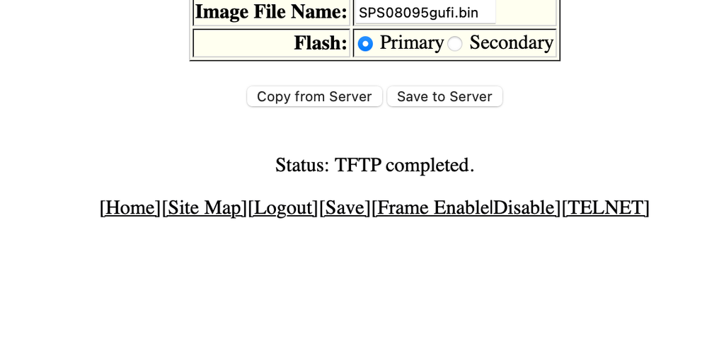

I tried to perform the upgrade as requested, however I am on a Mac so I'm unsure if it worked.  After reload I no longer see the switch or AP's online and when I enter the IP of the switch it doesn't exist.  I did receive the below message when I tried to do the first part in the Web GUI.
Screenshot 2023-10-05 at 3.00.44 PM.pngScreenshot 2023-10-05 at 3.07.33 PM.png
