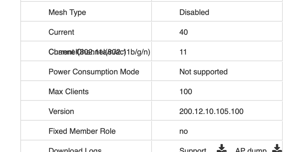

here is the requested screenshot.
versionversion
Under the switch section it also says disconnected and the following...
"Unleashed system only supports ICX firmware version 08.0.90 or later."
Followed by pending to join and a place to log in.  I have tried to log in with various credentials and it doesn't work.
Hi @pantherx13
As I can see your Access Points are on an older version, that is the reason you are unable to log into the Unleashed App.
We suggest you Upgrading your R510 Access Points to version 200.14.6.1.199 which was recently released. Once you upgrade your Unleashed then we can see the Switch connectivity on Unleashed later.
